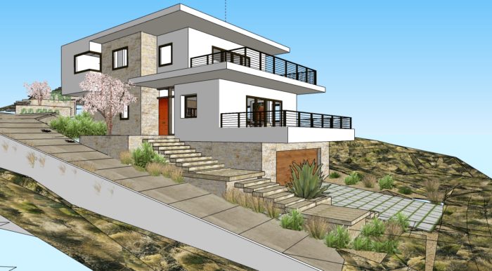

This is the proposed design. It's not yet final. Please feel free to critique.
Martin, thank you. There is something unsettling about an unvented attic. My mind tells me that attics need fresh air. I'll read the article again.
James,
I'm not sure whether the decks will be framed with wood or they are concrete slabs.
If they are cantilevered slabs, they might present serious thermal bridging problems.
In any case, these decks need to be insulated assemblies (because there is conditioned space below the decks). Since there is conditioned space below the decks, the decks need to be very carefully detailed for water management (roofing and flashing) issues. It's also essential that your designer and builder pay attention to the continuity of the thermal envelope at these decks -- meaning that you need continuity of the air barrier and continuity of the insulation layer, without thermal breaks.
Thank you Martin. They are wood decks. How would you insulate? It's just like a flat roof except you can't put rigid foam on top. There will be tile.

Q. "They are wood decks. How would you insulate? It's just like a flat roof except you can't put rigid foam on top. There will be tile."
A. Are you the designer? Or is there an architect?
If you want to install a tile deck over a wood-framed flat roof, with living space under the deck, everything needs to be carefully detailed: the air barrier; the insulation; the roofing and flashing; the dimple mat and coverboard above the roofing; and the tile deck.
If all this is new to your architect, you're in trouble. If your architect knows what he or she is doing, and is drawing the details, relax.

Thank you Martin. Do you have a link to a diagram showing the layers for a flat roof (ie rigid foam, sheathing, moisture barrier, etc...all the way down to the interior drywall? I don't have a builder retained on the project yet. I'm trying to get educated for myself. Appreciate the help.
Thanks Martin. Yes I have an architect but I'd like to know these things for myself. Often times architects and builders go with the cheapest not necessarily best methods.
James,
We can't give you a full lesson in construction in this column.
I already provided a link to an article that provides advice on insulating low-slope roofs. Here is the link again:Insulating Low-Slope Residential Roofs.
If you are a GBA Prime member, you have access to the GBA detail library. Click the green "Strategies and Details" tab at the top of any GBA page.
There are a thousand ways to screw up a "roof you can walk on" -- especially if you are designing a patio with tile flooring above a wood-framed flat roof. This article explains some, but not all, of the ways that you can screw things up:Decks—Roofs You Can Walk On.
Martin, if this was your house, would you go with a low slope hip roof over the flat roof? They wouldn't look much different from street level looking up. Thank you.
James,
I would never build a house with a low-slope roof. I would build a house with a nice steep roof with a 12-in-12 slope.
But this is your house, not my house. It's possible to build a low-slope roof. Just get the details right.
