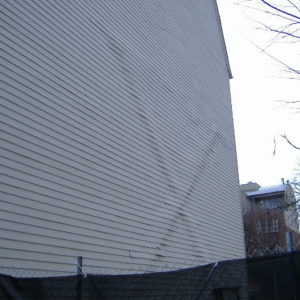

    The first photo.. not my project ....but I know it was 24" OC

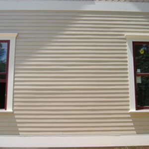

    I took the 2nd photo also .. but do not know the "story"
    Another comment about the first photo
    This was a Building America Project...Near Dallas
    护套是泡沫护套,腔隔热是开放的细胞泡沫
    泡沫护套可能导致了波动的外观

    My install is over structural sheathing and the framing is 16" OC
    我的壁板看上去没有“ wavey”
