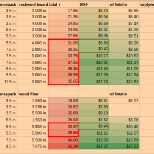

One more bit of info that I'd like to share. This is a spreadsheet I have been working on for a while, and of course it comes with the caveat that it is very unscientific and only based on my ability to get cost estimates.
The estimate for the dense pack is for installed cost, which throws off the numbers a bit. But I hope it is illuminating because it doesn't show wood fiber as being all that noncompetitive (with rockwool).
I have my own reservations about wood fiber insulation (like prejudice against MDF cabinets, IKEA furniture, etc), but I have yet to figure out if these reservations are unfounded. It seems, intuitively, that a rock fiber board would be more immune to the various problems (water, pests, fire, etc.) that the world throws at buildings.
In any case, I think I'm settled on 2x6 framing with outboard insulation, maybe rockwool, maybe wood fiber. I saw Mento over Wood fiber, which at the time seemed like overkill, but now seems prudent, if for nothing else but peace of mind.
