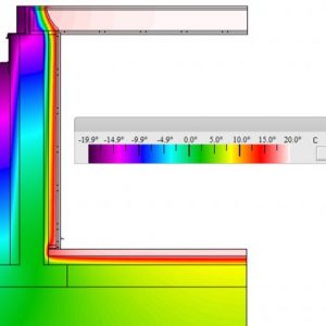

Here is a thermal image I found on Google, of a basement and I don't know where, but the point is that the "blue" cold weather goes quite a bit down the wall. The deeper your frost line is, the deeper you need to excavate to fix your issues.
也许在CA中的某些身体将为您的气候区具有实际形象。
