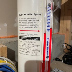

I have a home built by Richmond homes in 1995 in Superior Colorado. The basement floor is not concrete (soil issues), it’s dirt with a plastic covering and a few feet above that is a wooden basement floor. When we purchased the home 14 years ago the radon test came in around 4pCi/L so the original owner put in an active fan radon system for us before we moved in.

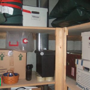

I have always wondered about two vents that run from the rim joist down below the basement wood floor. My guess is those two vents provide passive radon mitigation. It’s just a guess since radon gas is heavier than air and might not travel up the vent to outside.

Please provide a bit more info. It is unclear what your situation is based on the description and the photo.
Does the photo show what you believe to be a passive radon vent? Radon vents are usually made of PVC pipe. However, perhaps they made them of duct in the 1970s
Are you sure the photo you posted of the duct is not some sort of supply or return duct for conditioned air or moisture control under your wood floor?

I also added a pic of my active radon system.
