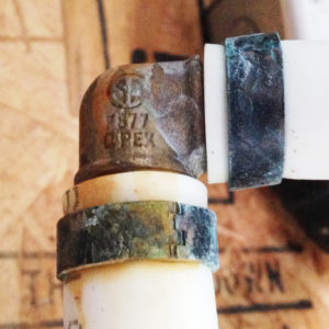

Here's an example of a fitting I am worried about. It really looks like it's about to let loose, to me (the crimp ring, at least).
That connection looks just fine to me, a little surface discolouration is all I see. The right hand one is asymmetrical, but it started out that way with a poor angle on the crimper when they installed it, not because it has shifted at all. As long as it held then it was first pressure tested, I can't see why it would let go now. As Bill said, it might be worth taking one out and looking at the inside to reassure yourself.
Thanks, guys, this has taken a load of worry off my mind. I would like to take one off and get a better look at it but sounds like it's not terribly urgent.

The fitting in the pic you posted looks fine. It just shows the usual petina grass gets as it ages. Corrosion would usually be a blue/green color and would have a crusty look to it.
