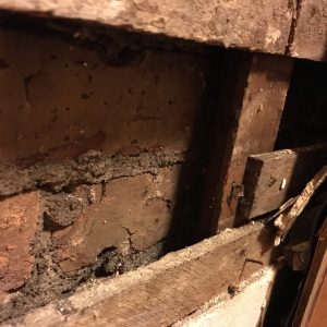

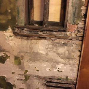

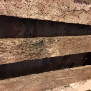

      Here are some pics. This is not a brick veneer, it’s at least 2 bricks deep with about a 2” furring strip holding up the lath and plaster

    嘿,得到你的名字真是太好了...
    The photos are difficult to read. It looks like you have a double brick wall and the wood lath is fastened to the brick with nothing in between. Is that correct?
    1. Cpros55||#5
      It’s Chris,
      Yes it’s double brick with some furring strips and lath.

      This is a classic case of chicken or the egg. Did the plaster go bad because of the paneling or the paneling was put on because the plaster was in bad shape. I would bet it is the 2nd case.
      除了水和冻结外,没有什么会损坏砖块。到达那里的唯一方法是添加过多的隔热材料而不能很好地控制水分。
      如果您没有绝缘的墙壁,则几乎没有机会损坏砖。就像我之前说的那样,您可以用1/4英寸的石膏墙修补。图片中的墙壁状状态不好,整墙都覆盖着1/4英寸的干墙,大部分都粘在了石膏板上。在那里呆了6年没有问题。
      如果您缺少较大的石膏部分,则最好用一些石膏板+一层Durabond填充,否则在这些区域将墙壁“柔软”。
