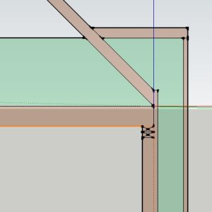

我已经附上了一个基本绘图的图像。棕色代表着框架,绿色是纤维素(没有将其延伸到像屋顶椽子上的天花板上,因为清晰的圆顶),橙线空气屏障。
My concern is the R-value achievable around the top plate and roof/wall intersection. Once the 2″ ventilation channel is considered, the top outside corner of the ceiling joist has about a 2.75″ cavity that can be used for insulation which ultimately presents moisture (cold spot on the ceiling) and energy issues. However the minimum depth from the top of the double plate when including the joist cavity is 7″ which is acceptable if spray foam is used.
Now since this is a complete rehab project, there is no issue with running a continuous interior soffit to allow for the proper insulation depth. Anyone have any input on whether that would satisfactorily address the issues? It seems like it would reduce, but not necessarily eliminate, the issues.

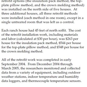

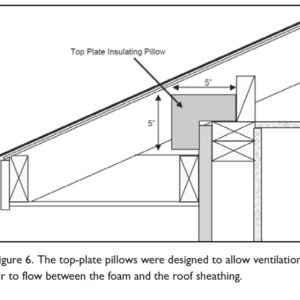

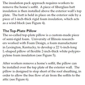

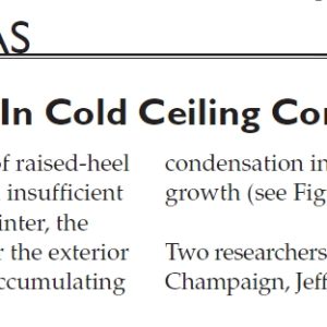

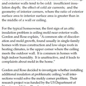

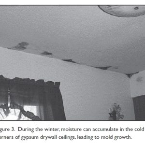

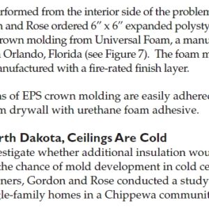

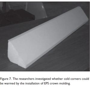

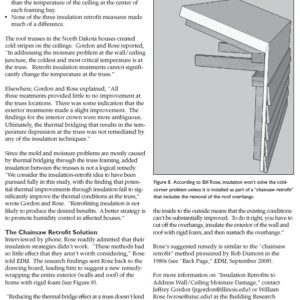

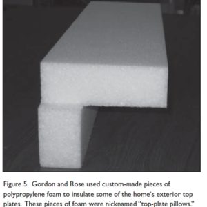

    您可能对2008年10月发行的本课题写的文章有兴趣能源设计更新。该物品被称为“防止寒冷天花板上的模具生长”。
    Reading it will take patience, because I'm attaching the article as 11 image files. I apologize for the awkward format.
  3. GBA Editor
    马丁·霍洛拉||#3
    Here are the last 5 image files.

    我认为这个问题更多地具有比托梁腔的热桥接。托腔腔提供了大约9“的喷雾泡沫可以提供足够的R值的深度。这将是一个相对较小的体积,所以我认为费用将是可容忍的。
    Once the flooring and ceiling is finished I will have about 7' 3" ceilings on the second floor which would make an interior insulation approach very difficult.
    I am hesitant to insulate the interior of the walls due to cold sheathing concerns, loss of space, and maintaining the air barrier. Also, there is brick in all of the stud cavities which I am leaving exposed on the first floor and unsure about the second.

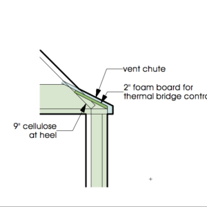

    顺便说一下,我认为你需要尽可能高的天花板纤维素的全部深度。IIRC博士Joe建议你在墙上的盘子上有同样的r。它可以看起来像这样:
