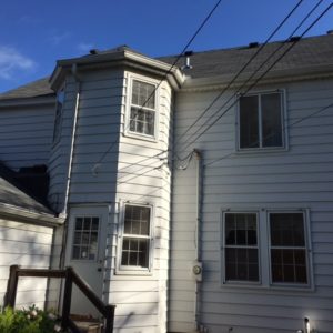

I need to address the insulation situation specifically above the 2nd floor bathroom. (Pic is not the greatest) The bathroom is located in the octagon portion in the attached picture. I can access this area via the walk up attic, bit it’s tight quarters, fun times.
托梁2×10的运行”到“这octagon area. I would presume I should cut square’s out of some left over XPS and foam them in place similar to what I did at my last house which was a cape cod. At my previous house I did this behind kneewalls, though unclear if this is a waste of time as the walk up attic is not finished. Hopefully that makes sense

See attached pic
Hopefully you have soffit vents on the octagon?

No sofit vents exist in this area or on either side of the octagon, instead have a small window in each gable end with a screen on it. It should also be noted no roof vent exists in the octagon, only on the main pitch of the roof which is visible in the attached pic
While it's not visible from the exterior or the attached picture, when I walk up into the attic the roof deck is cut out where the ocatgon is located, which allows access to this area (and what I will crawl to install the FG) I would assume this access point also acts as a passage way into the larger attic space for any warm/moisture to escape
