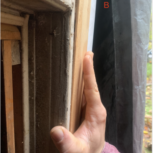

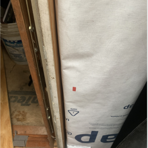

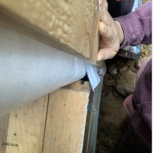

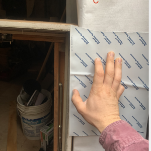

    Thanks for the advice thus far. I am getting even closer to getting them in, and wanted to share some pictures to see if I have the idea right. Excuse the floppy tyvek around the RO jamb, I haven't stapled it to the inside yet.
    照片A显示了我的窗框Jambs将如何为护套感到自豪,照片B显示了窗户的窗口,与我的1/2英寸雨屏毛茸茸的条齐平。
    照片C显示,一旦我将JAMB安装在适当的深度,我将在tyvek wrb上放一些剥皮和粘贴胶带,我将在侧面和头部做到这一点,但不要在底部。窗户。
    照片D显示了闪烁JAMB后的外观,然后连接毛茸茸的条。
    Since the jamb will be proud of the sheathing, the flashing tape will 'taper' back to the WRB. I guess essentially bulging out from the wrb. Especially on the head flashing, I feel like this will make a deviation to my otherwise flat drainage plane - but seems like the best way I can do this with the wooden windows I have.
    Siding will butt up to the trim.
    你怎么看?
