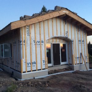

We meet with draftsman again today,we told him we would like to do 3/4or1 inch polyiso and also a rainscreen,he didn’t know much about the rainscreen and wanted to know how we will handle windows and trim with the extra depth,I have mentioned before but this is not normal practice in Oklahoma(zone3) so we are kind of questioning is it worth it to put these behind our hardie lap siding or just do one and not the other?
Sence这不是正常的做法,我相信建设者将收取的费用超过正常实践的区域的收费。
