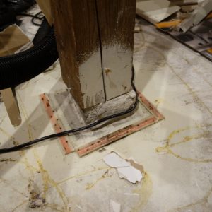

I've added a photo of the post detail. There doesn't seem to be a steel bracket, although the concrete has been built up underneath the post so that the post connects to concrete about 2" higher than the surrounding slab.
I think that the concrete being built up under the post helps you. How much foam are you putting down? I suspect the concrete/post intersection will still be above foam, won't it? I would live with that little bit of concrete that's proud of the foam not being covered and move on.
This is one of those things where there are numerous straightforward ways to reduce the risk of this becoming a problem in the future (e.g. replace the wooden post with a steel post right now), but where the expected value (in a probability sense) of that improvement is perhaps low. If, in 10 years, you realize the bottom of the post is rotting, so what? You replace it then and are thankful you didn't spend the money 10 years earlier. Of course, this is presupposing you're not covering everything up entirely and then having to dismantle it for a future repair.
I agree with Patrick that the raised concrete under the post is a good thing here. You really want a capillary break between the end of the post and the concrete though, and there doesn’t appear to be one from what I can see in your pics. The rigid foam makes the need for a capillary brake more important, so I’d try to add one as part of your project.
Are those tack strips around that post? Carpet on basement slabs is bad news. You’ll be much happier with your new insulated floor!
Bill
Yeah, I'm demolishing the old slipshod finish work. He had adhered thinset/tile directly to the slab, as well as carpet. The carpet smells very musty, but we had a couple water leaks in the past year as well that contributed to that (not water from outside, but a leaky water pipe in the ceiling). Can't wait to get a better floor that's not moldy/freezing all the time :).
If you need some drying around that post, leaving the rigid foam an inch or two out from the beam all the way around and filling the gap with mineral wool would probably work. This isn’t ideal though, you really want the beam on top of a bracket like roger mentioned, and only the bracket penetrates the rigid foam — the wood column would end ABOVE the rigid foam where it rests on the bracket.
