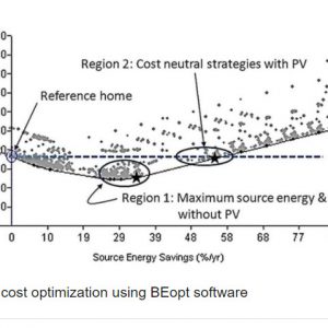

Have you seen the BEopt software there is no charge to use the software. The tax payers funded the project. You build a model of the home with the windows and doors overhangs. It uses your local weather data and fuel costs your interest costs your guess at inflation. The model runs every 15 minutes for a year to calculate the operating costs. You can compare the current home to a range on different models and their costs it draws a graph the house in the left cost the least to build the ones on the right cost the most to build. The ones at the top cost the most to operate given the fuel costs and the interests cost to buy the equipment. The sweet spot is the one closest to the bottom generally in the center.
https://www.nrel.gov/buildings/beopt.html
Learning to use the program and enter your first house will be slow 20 maybe 40 hours. The learning curve is steep after the fourth house I am thinking 3 to 6 hours to enter the data. If you decide to try it, be sure to find and watch the training videos on YouTube.
