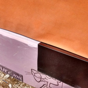

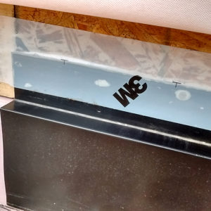

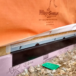

Absolutely, and thanks very much for the reply. Attached are three images to illustrate what we've been doing as we lay the skirt metal on.
My basic general question is whether or not we should trim the VaproShield up 1" or so off the metal skirting (see picture number three) and tape it to the metal?
After the metal skirt is on, we'll be putting up Roxul batts/strapping/siding on the walls. At the end of the day, the final vertical buildout plane will be proud of the vertical plane of the foundation foam/metal skirting by about 2 1/4".
When we peeled the VaproShield up to take those photos (North side of the house), we noticed a little moisture beading on the underside of the 3M tape, where it joins the skirt flashing flange to the sheathing. We just had a snowstorm, and there was snow piled against that side of the house for a few days, until about one day ago (it has since melted). That side of the house gets the least sun, and we checked the rest of the tape around the south wall and gable ends... no moisture under the tape there.
Maybe the moisture we noticed is just from the metal sweating? One side is pressed against the warm wall of the house, and the outside face of the metal is exposed to the cold? Maybe we should just leave the vertical flange of the skirting nailed - and not taped - to the sheathing?
And, if so, would that impact whether or not we should tape the VaproShield to the metal skirt?
I hope this helps illustrate things better.

If none of these membranes are part of the air barrier -- and you've said they aren't -- then I would just leave the lap as you have it. I don't see any advantage to adding tape.
If you're not happy with my advice, and you go ahead and use more tape, I don't think any harm will be done.

As a followup, should I be concerned at all about the little droplets currently under the tape that joins the skirt to the sheathing? Should we take that tape off?

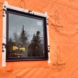

We've also been taping the tops and sides of the windows, to keep the VaproShield from ripping away when the wind gets under it (see newly attached image). The wind gets very high up here, coming right off the ocean and up the hill. We found our Dow Corning wasn't holding the VaproShield well enough on its own around the perimeters of the windows. The 3M tape seals it all up wonderfully, and the wind doesn't get under it anymore, however there is a little condensation on the back of the tape in some spots where it stretches from the window flange to the VaproShield, just like the aforementioned places where the metal skirt flange is sealed with 3M tape to the sheathing.
I wonder if all/most of this wont be eliminated with the addition of the rest of the wall buildout and flashings...
