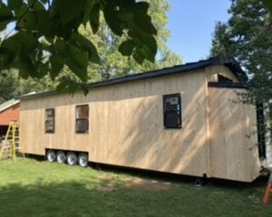

Okay. So I passed on the 1” in the walls. Now my question is, if I have my 2x6 joists on metal trailer and I may not have a skirt installed this winter, would I benefit from insulating the last 1.5” of my subfloor cavity with cellulose, could this cause condensation problems/rot from condensation in the winter, if so, should I put down a floor underpayment? I only have 4-4.5” of sprayfoam in my joists and I worry that It might not be enough and I don’t want to suffer with extremely cold floors, zone 5b

Hey Patrick,
I have a trailer with 4 axles, on top of the trailer is a subfloor built out of 2x6 joists. On the bottom of those joists is 3/8 ply, and spray foam is sprayed on top of the ply in between the joists. 3/4” ply will go on top of the joists.
A ha! Now I get it. Cool structure.
I suspect any comfort issues on the floor are going to come from lack of a thermal break between the outside and inside. Some cellulose on top of the spray foam might help, but probably less than you'd like. The joists coupled to the subfloor will act as heat sinks for the floor overall.
I don't know what the interior looks like, or if you have the headroom, but one option would be to put a layer of plywood down over the joists, then as thick a layer of rigid foam as you can afford above it, then another layer of plywood.
Hey Patrick, would there be any disadvantages to topping it up with cellulose? I can’t afford that much height in the tiny house lost with the rigid foam. I guess I’ll be cranking the wood stove haha
