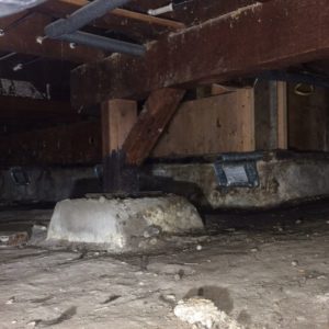

It’s ugly under these foundation vents in a stucco wall. Pictured is a 1938 stucco vent which was simply a screen stapled onto the tar paper. Everything looks fine, until you look at the sill plate. The second picture shows a similar vent where water ended up pooling due to the shape of the foundation, and probably the addition of earthquake shear plywood inside. I have now tapered the concrete so at least that part drains, but….

These are crawl space vents. Dirt crawl. Picture attached. I'm aware that a moisture barrier could reduce the crawl venting needed. This is the only vent on that side of the house.
