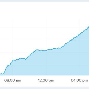

    I suspect the risk would be quite low. That said, CO2 levels can climb rather rapidly. On Sunday, I was home alone for most of the day with our HRV turned off and windows closed. At 06h00, CO2 levels had stood at 850 ppm and by 19h00 they had topped 1,700 ― no pets, no scented candles, no combustion appliances; 53-year old, 2,700 sq. ft. Cape Cod, not exactly air-tight.

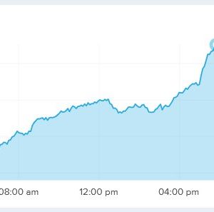

    There have been times when it has exceed 2,500 ppm (in this second chart, it hit 2,880 ppm before I turned the HRV back on).
