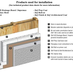

The proposed system would be the Impermea system by STEF. See image attached or link below.
http://www.stef.cc/en/Stefnov/SystemsVideo.html
Thanks
