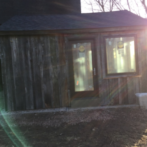

I’m renovating a small outbuilding on a farm (15′ x 15′), which has slab on grade foundation. The slab is sitting on crushed stone but has no vapor barrier underneath. I have put a 10 mil poly sheet on top of the slab, and 2×4 joists (sleepers) on top of the poly sheet.
My plan was to now spray foam insulate (about 2″ – 3″) on top of the poly sheet, then install subfloor and then hardwood.
However, before spray foaming, I can see significant water pooling under the poly sheet. Probably to be expected, but somewhat surprised at how visible. With these details, is the original plan (spray foam over poly) sensible — (with the goal being to thwart the entry of all water/vapor)? Or, is another vapor permeable approach a better way to go? Or dimple plastic? Any advice welcome.

Many thanks. The area uphill from the structure (about 30' away) has always been quite wet--there must be an underground spring somewhere nearby. So a couple of weeks ago I installed French drains around the building in anticipation of a possible water problem. The structure is also next to a large barn with a 60 square roof, directing rain water toward it. To deal with this, next week I am scheduled to install a gutter system for the barn as well as the new structure, (the underground drains are already installed). This should alleviate the water issue to some extent. But I am not confident it will fully mitigate the problem.
