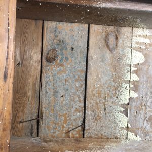

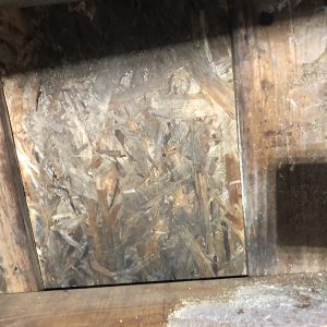

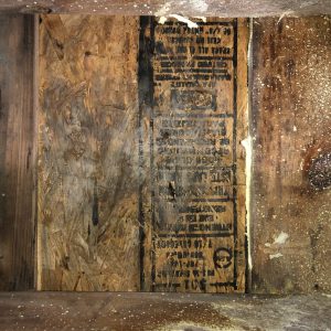

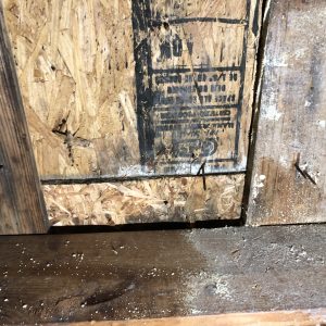

Over the weekend, I tore out the old ceiling and insulation to prepare for closed-cell foam. I found mold in the areas of concern (above the open cell that I tore out). I thought you all might like to see, so here's a couple pictures.
This might be a good read, sounds like the same problem you had. Replacing with the open cell with closed cell should fix it.
https://contractors.efficiencyvermont.com/Media/Default/bbd/2018/docs/presentations/efficiency-vermont-bbd-why-are-attics-insulated-with-open-cell-spray-foam-so-damp.pdf
