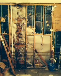

Thanks for the help. Here is a pic of the worst damage. (Dangling stud and remnants of barrier).
This looks like there is sheathing at all on the exterior side of the studs!!
This changes things a bit. How much distance is there from the stud edge to the brick?
Mostly it is 2 and 1/4 inches, except where there is excessive grout. (from the stud edge to the brick)

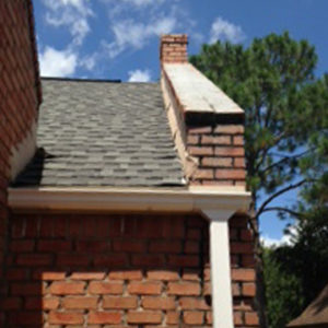

D, you had asked earlier how water drained from the roof. Below is a pic which should give some idea. Thanks again for your input..... :-)
With 2" + of space between the brick & stud edges you have sufficient space to install something there- the question becomes how attach it and air seal it.
You can probably install fan-fold 1/4" XPS siding underlayment (eg:http://www.homedepot.com/p/Owens-Corning-FOAMULAR-1-4-in-x-4-ft-x-50-ft-R-1-Fanfold-Insulation-Sheathing-10UM/100320301),glued to the stud edges with foam board construction adhesive inserting 2 x 2" blocks of EPS or something else as a compressive wedge to hold the XPS tight to the framing as the adhesive sets. Then go back over it sealing the seams with housewrap tape, and edges with can-foam before installing the cavity insulation. There are multiple vendors & types- don't use a perforated version or you won't be able to make it air-tight. Siding underlayments usually have a thin bonded facer bringing it's vapor permeance down to something between 0.8-2 perms, which is just about right, and it's possible to use fan-fold goods as the primary weather resistant barrier even under leakier siding than brick, provided it's taped correctly. Since you don't have structural sheathing it won't be quite the same as a weather resistant barrier application, but it's way better than nothing. Since it comes in 4' x 50' sheets you'll need 2 sheets per story. With 1/4" goods it's possible to lap it rather than butt-fit the sheets together. If lapped such that any moisture running down the surface drains to the cavity rather than getting scooped into the insulation it'll do pretty well, even if the tape/foam sealing on the seam isn't perfect.
