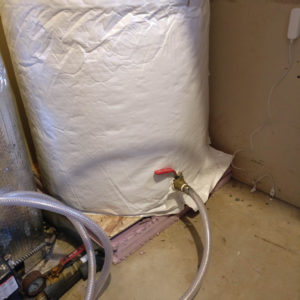

Norman, here's a shot of my water heater on a sheet of dricore and then 3 inches of basic rigid foam insulation. Even a 10psi rigid foam with that much surface area is going to be fine as long as the base is flat. That's where the effort is going to come in for you, making the base flat. Dana's idea of poring a small pad after compacting the soil is a great one and exactly what I'd do if it was even remotely possible to compact the soil a little.
