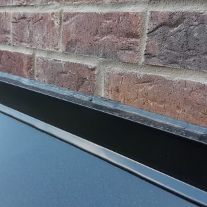

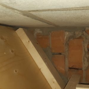

Hi Brian, reading the above comment we wouldnt be able to remove the gas fireplace and bump out . I did however check the air space between the sheathing and the brick and it is an inch. Any advice on how to insulate this space correctly to avoid any air leakages would be so helpful. Also just to show you we replaced the brick 45 degree angle with a Grace water /ice sheild on top of the 3 quarter inch plywood and then capped it with the metal roof with drip edges. The pic has uploaded the wrong way but you can see this the area we are most concerned about around the brick e.t.c

That's good news that you have a 1 inch air space and great that you are taking care of the water management issues. If the wall is not getting wet from rain or snow melt, the next most likely culprit is air movement through the assembly. So, you can fill the cavities completely with any type of insulation you choose, but more important even than the insulation is that you do a great job air sealing.
Before insulating, seal the bottom and top plates, all penetrations, etc. and make a plan to have an interior air barrier over the insulated stud bays. That could be a sheet good like OSB with taped seams, rigid foam, drywall, or a membrane (maybe dependent on the fireplace and clearances).
Unless you use a vapor-closed insulation like closed-cell spray foam, you will probably want a class II or variable perm vapor retarder in your cold climate (maybe your code calls for something specific). Depending on the product, this may be able to be your air barrier as well.
Once you have controlled water, air, and vapor properly in the bump-out walls, it's probably a good idea to make sure the cavity between the back of the fireplace and the bumpout walls is not creating a thermal bypass allowing air from whatever area is below (if it is an unconditioned space) to get into conditioned space; or allowing conditioned air from that space a path to unconditioned space above (if that's the case). Basically, try to seal up that area too.

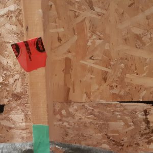

Brian, sorry just one more thing.. any suggestions how I should seal these big holes on the interior side of the osb that the builder did? Thought maybe they need to be sealed before I insulate that wall cavity. Thanks again.

There is no benefit to sealing the holes. You can put some of that red tuck-tape over them if you want, but would be entirely cosmetic.
Even if the hole is letting in air?
James,
You need to decide where your air-barrier is going to be and make it continuous. That is really important to stop your problem coming back again.
If it is the exterior sheathing you would need to seal every stud-bay and seam on the OSB, not just the holes.
If like most houses in Canada, it is poly on the inside of the wall, that needs to be detailed so it is continuous with the existing walls and sealed at the perimeter.
