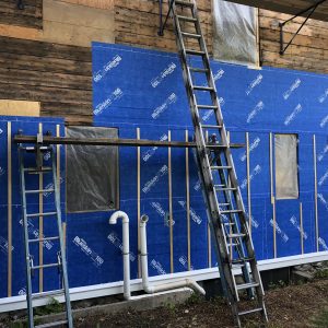

One benefit of most peel and stick membranes is that they can be installed in the vertical direction without any extra overlap. This makes installing on a ladder much easier as you can tack it on the top and peel the backing and adhere as you go down the ladder.
