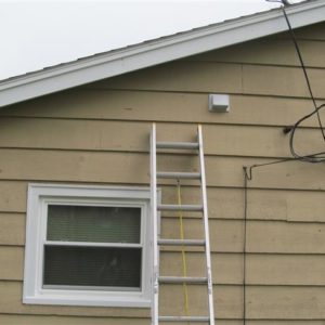

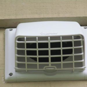

Go through the wall. Install a termination that directs the exhaust air downward (see photos), and don't worry.
Thank you! That makes me very happy.
