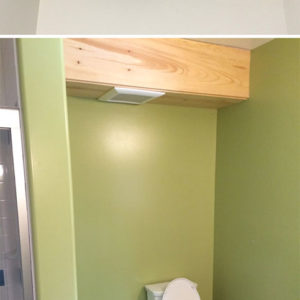

We did option 1 with a Panasonic Whisper Green in our house and I think it was a good simple solution...as it avoids having to run a duct into the attic (and the 20"+ of cellulose on the attic floor). We built a small chase or compartment out of 2x4s and pine boards, a photo is attached.
Brian, yes, I've also considered creating a dropped soffit in the bathroom to run ductwork to the nearest wall. This would keep the duct in conditioned space and avoid creating another penetration in the ceiling air barrier. But that could still introduce humid air in the my soffit above. Guess I'll go the gable route.
