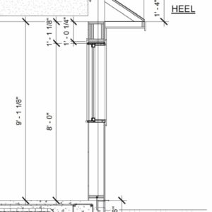

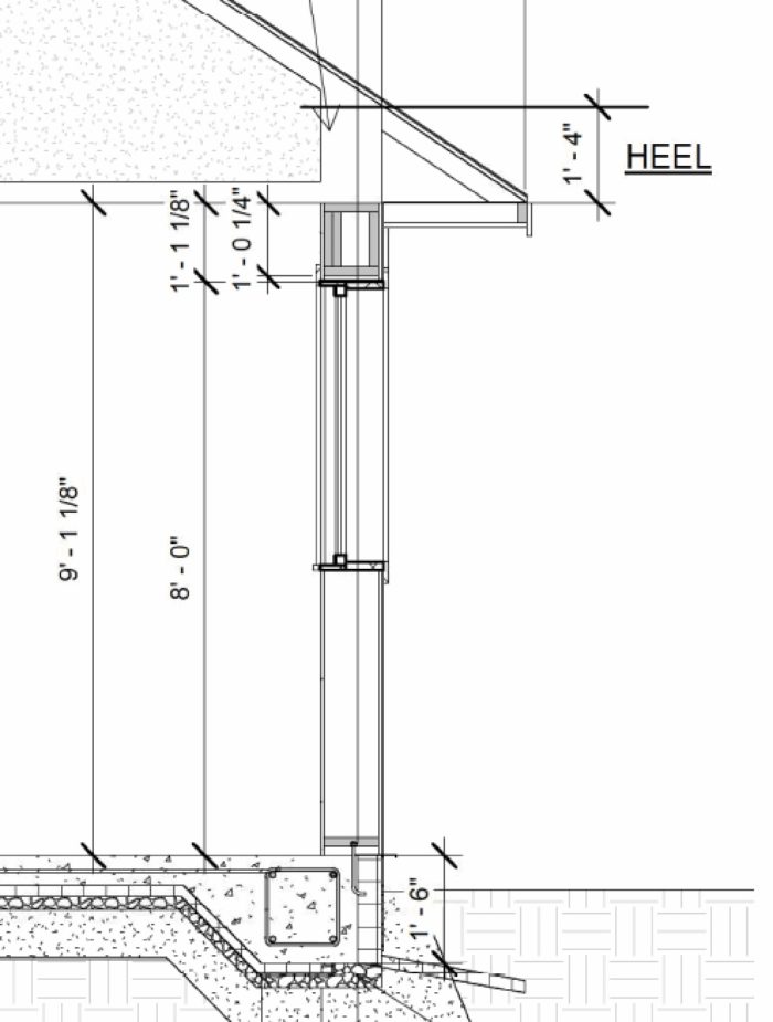

Thank you Brian. Yes I am using energy heel trusses and now that I look closer 9' would not even cover it anyway. I'm closer to 10'. Still curious about application strategy.
I am not a pro builder, so hopefully others join in this. I am also in Zone 6 (Montana) and building slab on grade with double stud wall and exterior plywood, so I am anxious to hear other comments as well. If your overall height is 10', one idea would be to run a 2' wide section horizontally along the bottom and an 8' section vertical above it to the top of truss. This would give the maximum strength in the wall-truss connection and minimize the amount of exposed seams. Since you are in snow country, the bottom 2' could be pressure treated plywood to ensure no rotting from drifting snow. Matt Risinger does this in his homes in Austin (check his OSB vs Plywood vid on Youtube), because of the amount of splashing water. Codes vary, but many require blocking between studs in areas where plywood seams would be, or 2' above the sill plate in my example.
如果你应用水平表可以使用thinner shear panel with the same shear value as the thicker sheets.( make sure you know the thickness of backing you siding needs) Look at the foot notes in the shear tables. Perhaps this help make up the cost of the additional blocking needed at the horizontal panel joints. This would require 3 rows of horizontal blocking.
If you install them vertically then with one row of blocking you can cover the full 10' height.
Staggering the joints is not needed on shearwalls. It is typically needed on a roof diaphragm.
