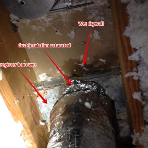

The register boots are insulated, and the insulation has a lot of mold. (pic attached)
有明显的水在阁楼上the blown in insulation around the duct boots: not damp, really wet.
I do not think the register boots are leaking, but I guess they could have small leaks.

Mark,
Your problem has nothing to do with attic ventilation. If anything, increasing the rate of attic ventilation could make the problem worse, not better.
The source of the moisture is exterior air (which in Houston is hot and humid, especially at this time of year). The crux of the problem is that your attic air -- which like the outdoor air, is hot and humid -- is able to contact cold surfaces, leading to condensation.
The solution is to create an air barrier -- specifically, an air barrier with a decent R-value -- to separate the humid attic air from the cold components of your air conditioning system (the duct boot, register, and nearby drywall).
Locate the air leaks and cracks near these areas and seal the air leaks (as well as the entire exterior side of your duct boot) with closed-cell two-component spray polyurethane foam. That will solve your problem.
What he said- the duct boots are much colder than the dew point of the outdoor air. If the insulation at the duct boots is air and water-vapor permeable (any fiber insulation), water from the attic air will condense on it, just as a cool beverage bottle will collect moisture on it when exposed to humid air, but not in the dry air of the refrigerator.
Increasing the amount of ventilation to the attic won't make it better, but could make it worse.

All of the damp insulation needs to be removed and thrown away. You need to expose the duct boots, the back of the drywall, and any unsealed duct seams.

Mark,
In your original post, you wrote, "There is significant water in the attic on the blown-in insulation around the duct boots: not damp, really wet."
That sounds like water accumulating on the attic side of the register boot.
Then, in one of your more recent comments, you wrote, "The mold/mildew seems to be confined to the interior of the register boots, and along the perimeter of the boot/drywall junction in the conditioned space."
So which is it?

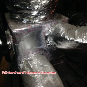

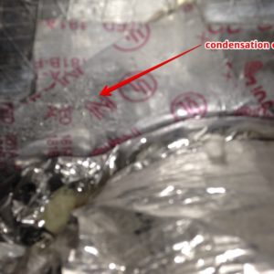

There is also condensation accumulated at the four plenums in the ductwork system. Again, the ducts are connected to the plenums with ties, no tape or mastic. The same connection type used at the register boots.
I guess I'll eventually need to open up all the plenum and inspect for mold/mildew.
I presume the best solution for my problem is to put the attic inside the conditioned space, but that will require replacing the gas heat and gas hot water heater, vacuuming out the blown in fiberglass,... Seems like an expensive proposition, maybe $20-$30K,...
I've attached some additional pics showing the register boots and plenum.

Mark,
It sounds like the moisture formed on the attic side of the register boots, and that the water dripped down to soak the drywall at the edge of the boot. The moisture also wicked into the insulation near the register boot.
Whether or not mold is visible depends on food supply for the mold. The paper facing of the drywall is an excellent food for mold.
