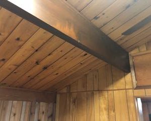

Hello-(抱歉,这是长)将在随后的帖子澄清。1970年的家在NC气候区4的山,我认为。我远程位于家庭成员试图让reroof添加了一定的保温得当 - 优于它得到它,但它不会达到现代R /效率的代码。房子有低效电踢脚线 - 并且通常是空的常年 - 除了探亲,楼下是占据水平租户(楼层之间绝缘)。带状疱疹已经脱开,屋顶是防风雨,但需要最终的屋顶今年秋天上市。在帮助我的家人也无法重新屋顶 - 我发现天花板是屋顶甲板 - 榫槽板 - 外露4×4清楚松椽梁内侧48“中心的内部 - 没有阁楼空间没有发泄的空间,没有地方绝缘内 - 内木材是有吸引力的天花板 - 松木屋的外观不是空气或蒸汽紧张。屋顶由坏通气靴和廉价的带状疱疹作业从90年代泄漏 - 气动通过瓦到纤维板“甲板”并不好钉基座(1970瓦手穿过纤维板钉入1.5“T&克屋顶平台/天花板)。在撕下1“纤维板在屋顶平台的顶部发现了 - 老柏油纸钉到它(哇老30磅毡是真正的交易与较新的“#30觉得”不等同/这么薄) - 所以没有硬护套层为木瓦安装在上面。 Much of fiberboard had soaked up moisture/keeping moisture in contact onto pine deck – though felt paper had done good job amazing it hadn’t rotted through more. Lovely pine Ceiling intact. 1″ fiberboard was 1970’s roof insulation – only insulation on the ceiling – in a place that gets pretty cold – or used to before climate change. Primarily concerned with future winter use, keeping heat inside – and preventing problems during winter from warm heated air/moisture vapor moving up into roof sandwich and condensing to form ice or to keep sheathing/decking wet leading to rot, etc. trying to get it re-roofed and put back some amount of rigid foam on top of the roof deck to replace where the fiberboard was removed and to better insulate the interior ceiling/rooms. (AC is not present – it is very damp and cool there in summer – and assume 70’s family spent a lot of money on elec heat with this scant ceiling insulation.). Need to keep it simple with available local crews to get this done in next 2 months – using conventional roof/framing/metal crews I can find nearby. will not be able to meet new code requirements for R value but would like to do better than the old fiberboard. Very concerned with winter moisture migration up into roof/vapor and moisture barrier strategy for foam board/protect ceiling/roof deck and new plywood deck I assume I’ll put on top of foam. Was thinking 3″ of rigid foam board – topped by new plywood sheathing – 5/8″ or 1/2″ 4 ply? Onto purlins? (I know this is but a fraction of required R value – but will be better than 1″ fiberboard it had for last 45 years. roof deck is low-ish slope 3 or 4 in 12 I think – so metal would be ideal if I could afford. 1. Really need to nail down the moisture and condensation possibilities here – it is likely not used in forseeable future much in winter – so indoor heat and cooking moisture isn’t an issue – but suppose it could be sold or used differently in next couple decades. How do I make sure any interior winter moisture does not migrate up into the roof and condense where it can wet the roof boards unseen – and lead to ice dams, or unseen wet plywood/deck/rot in the roof sandwich on the exterior side. I need an air/moisture vapor barier applied to the top side of roof deck to stop any moisture from moving through and at that point I need it to be insulated enough so it doesn’t condense there? Is this just peel and stick membrane? Can titanium nail on-non peel and stick if taped and sealed work for this barrier? 30lb felt? I can’t put anything on the interior – and the t&g is not vapor/air tight. 2a. how to most economically apply 3-4″ of foam board to the exterior side of the roof deck (which is the ceiling) so I can then put a shingle roof over it – assume I want to put rigid foam down with spaced out purlins which are screweed down into the rafter beams below? (can’t attach to the t&g roof deck as it is 1.5″ and penetrations would be inside the visible ceiling surface) Also ease of construction working with local crews, whre to get it, (salvage foam boards?) Then put new plywood sheathing on top of this – and peel and stick – and then shingle or metal roof (budget depending)? 2b. Do I need thermal break for purlins – if I run purlins on roof deck screwed down into rafters and put foam between them I’ll have thermal break through wood to wood running out to exterior. Do I need to divide foam into 2 layers so no wood to wood thermal bridges are present? 2c. Can I skip the purlins alltogether and lay foam and then screw plywood deck down through foam into rafter beams on 48″ centers inside? would need 6-8″ screws to do this – and new deck would just be on top of the foam. 3. can foam panels be directly glued or screwed to roof deck (being careful not to penetrate 1.5″ thick t&g deck which is the interior ceiling – and or hit rafter beams on 48″ spacing? Then cover with plywood laid on top of foam board and screwed down through onto rafters at 48″ centers down below? (any penetration of 1.5″ roof deck/is the ceiilng and will be seen in the finished space – so only 1-1.25″ penetrations allowed and/or only on the 48″ rafter beam centers. 4. can plywood deck sit on the foam? 5. can i do a metal roof with foam and purlins and skip the plywood deck? – but walking the metal roof would be walking on the foam under the metal. 6. local rigid foam – lowe’s, HD, bulders supply, salvage? THanks for any input/thoughts/referalls/links/Western NC suppliers/contractors, etc. some photos attached to give general layout/interior ceiling etc.

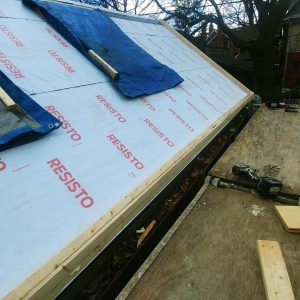

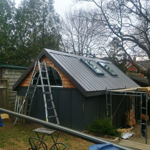

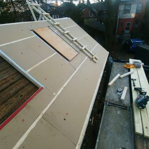

    这是我隔离一个类似的T&G屋顶工作室的方法。
    首先你需要一个固体空气和蒸汽屏障。用T&G做这个的唯一方法就是用果皮和棍子。你可以试着把现有衬垫的接缝用胶带粘上,但通常会有很多钉针和小孔穿过这样的东西。
    在果皮和木棒的边缘上有2倍的木材(在这个例子中是2x3),在它之间有2英尺宽的刚性绝缘板。在区域4,你不需要疯狂的绝缘,更多的总是更好的,但甚至3“-4”是好的。
    如果你要使用金属屋顶,你可以跳过屋顶甲板,在上面安装一个合成衬垫,然后将金属屋顶拧到2x的边缘。
    对于木瓦,你需要一个新的屋顶平台,在这种情况下,我会跳过边缘的2x,用长紧固件将新平台固定在椽子上。

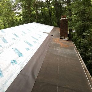

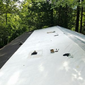

    两张照片,其中一张是钛的笔迹,下面是颗粒状的冰和水,下面是横跨外墙和烟囱,这是后飞机。其他显示白色屋顶涂层(钛)没有烟囱-这是前平面。
    带烟囱的后飞机-我在想我应该在这上面剥落一根木棍(木甲板在下面-突出部分在两层冰和钛下面的水颗粒之下)。#30毛毡-由钛覆盖。-然后我把果皮和木棍放在上面。然后4"泡沫交错2"层,然后2x的平,然后CDX,然后顶部衬垫。
    前平面与涂层钛udl -有1“泡沫的一部分”纤维板在上部分,它仍然完整地得到它的冲洗(t&g甲板下面)。两层剥离贴覆盖悬垂和外墙之上-然后钛到山脊。这一面有完整的弹性体涂层和每个帽钉密封的闪光胶带,以保护它,而它等待最后的泡沫和屋顶。这一边看起来气密得很。你认为它好吗?4英寸的泡沫将在这上面,然后CDX,然后在屋顶之前最后的衬垫。

    没有剥离和粘在任何衬垫上的意义。你需要在毛毡上镀上钛。颗粒状的果皮和果胶已经是一种蒸汽屏障,应该没问题。试着密封外墙板上面的T&G槽,小的间隙乘以几十块板等于一个大洞。
    一定要把所有的接缝都粘上。虽然不理想,但比以前好多了。
