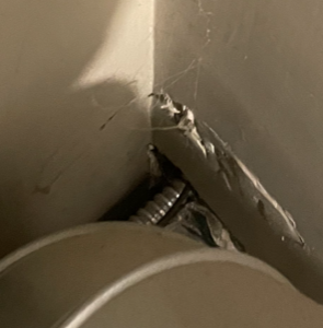

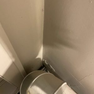

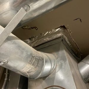

    Any advice on air sealing where my supply plenum exits the first level through the ceiling and goes into the attic?
    1. Expert Member
      比尔·威奇斯||#7
      I would use the softer "door and window" canned foam here. The softer foam will be less likely to seperate and leak due to vibration of the ductwork. You'll need a heavy application of the stuff, ideally wrapping around both sides of the edge of the drywall a little to help hold the foam layer in place.
      Note that a more elegant solution would be to use a sheet of EPDM to make a sort of flexible grommet, but that would be very difficult to install after the duct is already in place.
      Bill
  5. paula_builds||#5
    I am pretty into the duct seal putty - put it around the ducting penetrations as well as around exterior electric boxes. What do people think about the longevity of duct seal putty? I found it really sticky and good for covering wider and narrower gaps. It's supposed to stay soft. Thoughts?
    1. Expert Member
      比尔·威奇斯||#6
      You have to really work this stuff into the gap to keep it from loosening over time and seperating. You can't always see when it seperates, but if you wiggle it you'll feel it move free from the surface. That's not a good air seal :-) I find that the material itself does eventually get hard and fail, but it tends to go 10-15 years or so, maybe more. The more exposed to sunlight it is, the more towards the low end of the lifetime range it will get. This material is very commonly used by electrical contractors to seal around conduits where they go through walls, especially masonry walls.
