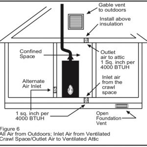

My venting configuration follows Figure 6 below. MU air from the crawl space AND from the attic. I was just showing Figure 7 because it illustrates what you were suggesting. Our attic ventilation is a combination of eave/soffit vents, ridge vent, and a few turtle vents in areas without ridge vent.
The figure shows the same 1 sq inch per 4,000 BTU. For a 76,000 BTU/h burner, that equates to a 5 inch diameter fresh air inlet in the ceiling and the floor. The ceiling pipe extending into the attic appears to be 5 or 6 inch in diameter.
