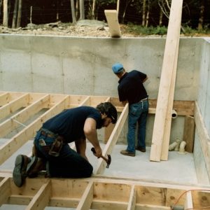

I am looking to insulate my 1986 house’s vintage poured concrete crawl space, but I need guidance! The house is located in zone 6A, right on the border of 5A. See the attached photo for the cross-sectional details of the house.
The entirety of the crawl space is below grade and is unused space. The goal of this project is to minimize the moisture, cold air, and radon into the house. It has an opening with a bilco door.

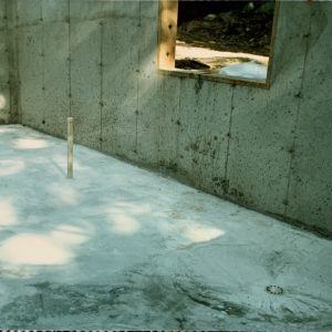

Yes, the foundation was built to the plans and is approximately 600sqft. I do not have evidence that they used the 4mil poly, but they did wrap the upstairs interior portion of the concrete block in what appears to be poly (see final photo), so I am going to assume that by proxy that they did so for the slab.
The foundation is poured. It used to get a thin layer of silty water in one corner (upwelling between the slab and foundation wall) during the spring thaw as the exterior area was previously graded towards the house. I had it substantially regraded, and water infiltration has not happened since.

Your sewer appears to be exiting the building above the floor so I think your floor drain in very suspect. Does it drain to daylight? Is it draining to a lift pump? Is it open to the rock below the slab. I would tape it close in the absence of an answer.
Thanks, Mike. I believe that the floor drain just drains below the slab. Thus, either using that point or expanding that spot as the sub-slab point might make the most sense.
