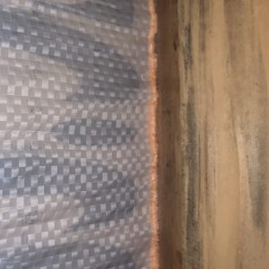

Hey everyone, got a question about the correct way to finish my basement walkout walls. I live in Missouri and fiberglass blow in blanket insulation was installed in June on my walkout basement walls above grade. Before this installation, in the winter I would have trouble with condensation on these walls behind unfaced batt insulation. Before they installed the blow in blanket, they picture framed the stud cavities with spray foam(不是整个腔)和喷雾泡沫rim joist cavities. So what I have now from the exterior to interior (wood siding, house wrap, framing, fiberglass blow in blanket and the netting). Trying to figure out if I need some type of air barrier, vapor retarder (membrain by certainteed) or something over the insulation netting to stop vapor or warm air making it to the wall behind the insulation in the winter. My plan is to leave the basement unfinished. A picture is attached. I appreciate any help you can provide for me, thanks.

It was open cell foam and I would say probably close to an inch thick. The only picture I have is the one below. I understand now I could have used foam board in these cavities or could have spray foamed them as well. Trying to see if there’s something I can do now to stop an issue if there will be one down the road, thanks.

It's hard to tell for sure from the picture, but does this mean there is NO structural sheathing (plank, ship-lap, OSB or plywood) between the framing and the housewrap?
If there is no sheathing, what is the housewrap product that was used?
With most wood siding there is at least a small crack/gap between the siding and housewrap acting as a capillary break (though not a really great capillary break, the way a rainscreen gap would be). When blowing the fiberglass a flexible housewrap would then be pushed tight to the siding, offering essentially NO capillary break. Without any capillary break and no sheathing the vapor retardency and other characteristics of the housewrap starts to matter, since any wind-driven rain (or even dew wetting moisture) that gets behind the siding is potentially drawn into the fiberglass, with only a limited path to drying.
