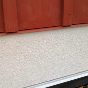

Up here in Pennsylvania I ended up going with a cement board stucco system on our ICF foundation:https://www.basf.com/us/en/products-and-industries/General-Business-Topics/acrocrete-eifs-stucco/wall-systems/cement-board-stucco.html
This seemed to be the most robust solution and also allowed us to match the synthetic stucco with other non-ICF foundation/wall areas. I grabbed a quick picture this afternoon to show the "stack up".
From top down:
A. Hardie board installed using a rainscreen system
B. Rainscreen vent area
C. Upper flashing set in a kerf that was cut into the ICFs to the concrete layer (insect barrier).
D. Cement board stucco, installed on top of a mesh rainscreen that was applied to the ICFs.
E. Flashing/kickout
F. Truexterior trim board at grade.
-1. Designed to be somewhat easily removable for inspection of the ICFs (insects).
-2. Paint can be retouched if it gets nicked.
-3. Keeps the stucco/cement-board away from ground moisture.
G. Platon dimpled membrane extending below grade.
How we handled insect worries may be the most extensible element of what we did here.

Thanks for your comments. Indeed, that looks like a robust, well-installed system.
