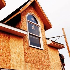

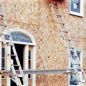

Kiley- Thanks for the reply. In my case the structure of the overhang is a SIP panel, and I am assuming the soffit is primarily attached to the facia and the external wall panel (I have attached pictures taken during the construction by the former owner). In any case , if I understand correctly, the solution would be to install the stainless steel mesh screen above the soffit so it covers the entrance. I also considered that removing the soffit will provide access to the area where the wasp build their nests and it will also provide the opportunity to seal any opening between the wall and the roof. This is not a job that I will be able to do myself but I am trying to figure out all the details before I find a contractor.
