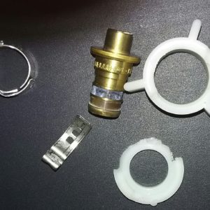

Thanks for that suggestion Malcolm. I hadn't considered the tension on the pipe between the shut-off and the sink. I've attached a picture of the fitting. The plastic disk that holds the plastic nut to the brass nub is what failed. It didn't shatter into lots of pieces, but separated as soon as I touched it which is why I chose the adjective "shatter" to describe the fail. The clamp is in two pieces because I cut it off.
I agree with Malcolm. Replace the swivel fitting with a pex angle stop. From there you can use a stainless braided line to the faucet. With supply lines, be careful not to over tighten. They are not like threaded fittings that need to be torqued excessively hard. Tighten according to manufacturer instructions, which is usually only a half turn past finger tight. The rubber washer will do the rest.
