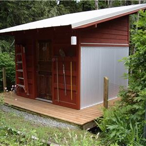

The other problem with moving the collection of roof water from the eaves to the ground is that it means relying on the cladding much more to deal with both wind blown rain, and splash-back. I did an experiment a few years ago with my shed and added a small length of gutter just over the door. This allowed me to walk in without getting wet, but I soon noticed that even with very deep overhangs the siding on each side was wet from grade to about 18" up. I soon replaced the small length with one that ran the full distance.
