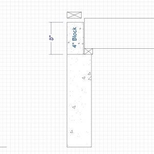

Hey Malcolm,
I had thought about block, but not 4". Are you thinking cutting back the joists to where i'd have 2" bearing left after adding the block to my 6" wall? My concern with this is that i feel like in the right circumstance, any water or moisture find the separation from the block to poured wall and marinate my mudsill and joists. I attached a detail, Is this what you were thinking?
兰迪,
如果是我,我将在两种情况下都使用膜并闪烁。切断托梁,铺设块等是很多工作。
如果您确实使用了块(假设墙壁8英寸),我会剪掉托梁您将没有块 - 我想这是关于为什么要使用块的问题?
