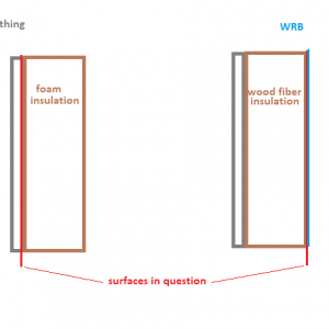

然而,这使得鞘的背面是直观的,用于冷凝表面的后侧仍然是:
-rigid foam insulation
-peel and stick membranes applied to the exterior of wood fiber insulation
i.e. in these situations do these surfaces have enough thermal mass to produce condensation?

I think I'm probably lacking in understanding of something, but just to be sure, my original question was not about the sheathing behind either interior surface of the rigid foam or interior surface of the wood fiber exterior adhered membrane--rather it was about those two surfaces themselves.
Having thought about it briefly after reading your reply (albeit without reading the link--sorry!), I'm guessing the answer is probably not because presumably the sheathing is acting like a sufficient enough vapor throttle + there is enough insulation between the interior surface of the rigid foam/interior surface of the adhered membrane such that no condensation will occur
