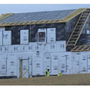

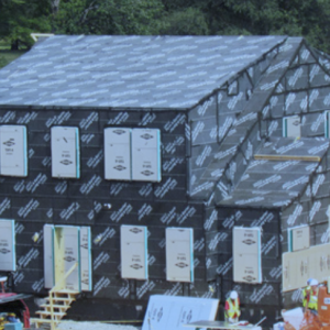

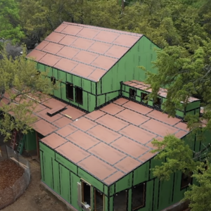

For wall/roof intersection, we are thinking of following Joseph's Darth Vader House concept, but using Zip sheathing to connect wall to roof like Matt Risinger's house. The rafters will be under the fully enclosed Zip sheathing. Then lookout overhang sits on the top plates with exterior insulation in the cavity and above it. Please see attached photos. As non-professional, I picture taping the wall/roof intersection with Zip tape all around. Is that a viable construction method?

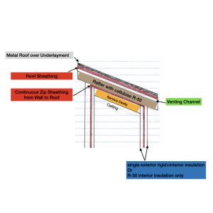

As northern Virginia is at the top of zone 4, close to zone 5, we did take the overkill approach. Your ROI point is very valid especially considering the simple shed roof. I have done a quick sketch based on your suggestion except for still keeping the two separate roof decks. As we don't have a high performance builder on our team, we like the extra insurance of a second air barrier, plus the continuous Zip sheathing from wall to roof. Is that over thinking?
Please advise if my understanding of your suggestion is correct as presented in the sketch. Much appreciated!

Your drawing should work well. OSB is something that is often used as a ceiling air barrier, like you said, hard to screw up. Since it is not exposed to water, it doesn't need to be Zip, standard OSB will work just as well. You can still use Zip tape.
Thin foil faced rigid will also work as well, for the same cost as OSB you get some real R value bump.
You'll still have to figure out the exact details of your air barrier transitions. The important ones are foundation to wall, wall to ceiling.
The typical wall/ceiling transition is to install a 10"-12" strip of OSB on top of the wall overhanging to the inside. This strip gets taped to the sheathing on the outside. Install the roof framing over this followed by the OSB underneath. The OSB under the rafters can now be taped to this strip for air barrier continuity.
Because of the roof slope, you will most likely also need an extra tapered top plate above each wall to match the rafter slope.
You can squeeze a lot of efficiency out of pretty standard construction by getting the details right. Lot of these details are pretty simple but they do have to be figured out beforehand.
