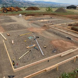

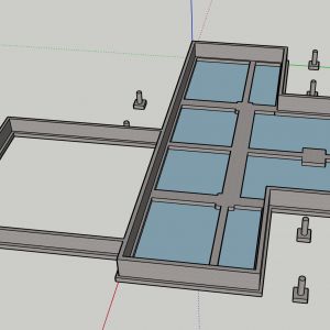

    Running some drain tile around inside the crawl space sounds nice for radon purposes as well as a fall-back safety for water issues. But the crawlspace subfloor is going to be pretty chopped up with various pony-wall footers. See the attached image for an approximation of the foundation. The 3/4 gravel is already compacted. But I supposed I could dig some trenches into it to run drain tile under the interior footings to create a loop around the interior of the foundation. Then I could run it out to daylight under a parameter footing. But if I do that, would I be okay to place the drain tile in a little trench, cover it would a bit of gravel, and just wet it and tamp it down a bit with the end of a shovel handle or something? I don't want to have to rent a compactor for this alteration. And would I be okay just placing drain tile in that way without a sleeve or compression wrapping or anything like that? Should the sections going under the footings be non-perforated tile?

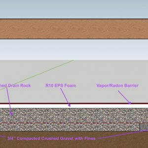

      1. brentwilson||#7
        有关完成爬网空间的一些计划,请参见附件图。这看起来可以接受吗?

    彼得·恩格尔||#6
    我对照片有些困惑。我们认为将是垫子的紧凑型石头,而基础上的基础在上面?如果是这样,您会用足够的石头填充内部装置以覆盖3英寸的管道吗?这将使排水管的放置容易。
    If not, I think I would probably skip them, unless radon is a big risk in your area. That close to the mountains, I'm guessing that your soils are pretty free-draining. If so, I would definitely lean towards skipping interior drains. It also looks like your crawl floor is going to be close to grade level. Even less risk of water rising up under your slab.

    1. brentwilson||#8
      Yes, the compacted stone that you see in the actual photo is what the footings will be sitting on. The area between the footings will then be filled with the crushed drain rock up even with the top of the footings - so yes, plenty there to cover 3" pipe. But that crushed drain rock also extends down approximate 5"+ below as well. See the attached diagram for a better idea of what I am looking to do. If I put 3" pipe in level with the bottom of the footings, there will be about 6" of drain rock above the pipe, and about 5"+ below the pipe. In that case, would the pipe be very useful? If I were to dig that pipe down lower, it would end up below the grade of the footings.
      我与一个工程场所的一个人交谈,该工程已经为这个项目完成了结构性工程,他似乎对管道的想法并不满意。他似乎对它的立足点更加满意。在基础下运行管道会使它接近实际的土壤等级。
      Maybe I should just skip the drain pipe. As I recall, I saw something online showing that a lot of Idaho has high risk for radon, but the county where my parent's house will be was more moderate. But I would like something in place in order to reduce any risk from radon. It is just a bit more complicated with all those pony wall footings cutting through the crawlspace floor.
      Would one passive radon stack with a pipe up through the roof and teed out for several feet in one of the sections between footings be helpful? In that case, there would not be radon pipes going through footers to all the different sections, but maybe it would reduce the pressure a little under the vapor barrier to help prevent radon getting into the conditioned crawl space and thereby into the house?
      另外,关于如何通过小马墙详细说明蒸气/ra屏屏障的任何建议?我当时想将其延伸到地面上,并在其顶部建造小马墙的木材部分。但这意味着它将在小马墙螺栓上有孔。

    彼得·恩格尔||#12
    您可以将VB在泡沫下面而不是在其顶部运行,然后直接穿过小马墙的下方和窗台之间。这也将有助于保持门槛干燥。无论VB在EPS上方还是以下,您都必须使用相对硬的EP进行踏步(和膝盖)流量。我总是喜欢在地板上至少有一块老鼠平板(2英寸)。如果您将平板平滑漂浮,您会在机械师的爬行者上爬行。您不知道这是多么好当您在爬网空间的尽头工作时。
    For the interior drains, I would put them at the same level as the exterior drains or even slightly above. You want the exterior drains to do the work. How are the exterior drains draining? Do they drain to daylight, or something else? If not to daylight, then there's no point in connecting the interior and exterior drains. The interior drains can then drain to a sump pit. Get one with a sealed lid if in radon area. The lid itself can be the radon suction point if necessary. I wouldn't worry a bit about running the drains through the pony wall footings. You only need a single pipe around the whole perimeter, and the reinforcement in the footings can go over the pipes and still be in the middle of the footing. Or, you can run the pipes near the top of the footing and run the reinforcement under the pipes, still with plenty of concrete around the reinforcement to do its job. You just don't want the pipes higher than the footing and I wouldn't run them lower either because then they will collect rising water before the exterior drains do.
