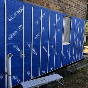

我的定价方面的平方英尺几年前(including Tyvek, Siga, Henry, Benjamin Obdyke, etc.). My specific needs were to water and air seal 100 yr old gapped board sheathing ... self adhered was highly recommended. I used VP100 which came in the middle of the price range with a good perm rating (relatively vapor open). I see lots of VP100 going onto old houses West of Boston.
I was also interested in the HydroGap SA product, but it was not yet available for sale. We instead did 1/4" plywood strips outboard of the VP100 to provide air gap behind the siding.

Providing a good air and water barrier for the gapped board sheathing drove the decision for self adhered WRB. Ability to dry outward and good value were second and third. VP100 had a perm of 33 (?) and mid range cost. Used a lot in my area. Plus the local Henry rep was fantastic, visited my site a few times.

One thing that really helps with most peel and stick air barrier membranes is they can be installed in vertical strips with the same overlap requirement as horizontal install.
Installing in vertical orientation is way easier. Cut to height and staple to the top of the wall, peel back the release film and adhere it as you work your way down the wall. Can be even be done on a ladder, no scaffolding needed. Quick and easy, less wrinkling and less chance of it sticking to itself.
