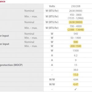

        9和12K模型的详细符合如下:

          I note that the rated heating capacity is only the same as the rated cooling capacity - typically, the heating capacity on a cold climate model is a step higher than the cooling (e.g. for a Fujitsu 12RLS3H, the cooling is rated at 12kBTU, heating 16kBTU). If I extrapolate the information you provided (100% at -15C, 80% at -30C), then the output of the 12k Ouellette unit is 12kBTU at -15C and 9.6kBTU at -30C. In comparison, the equivalent sized Fujitsu is 16.5kBTU at -15C and 11.5kBTU at -26C.
