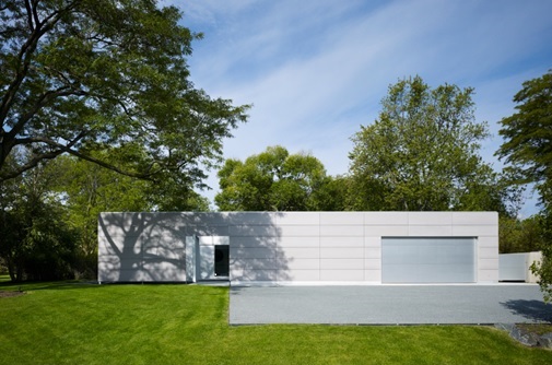

I'm trying to recreate the look with 5/16" cement fiberboard
I have read that the Reveal system uses the thicker material to avoid undulations that can occur with the 5/16" panels

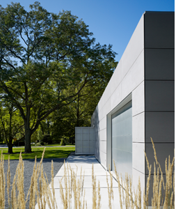

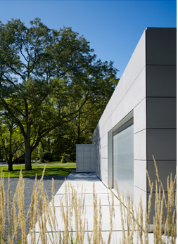

This is the look I am trying to achieve

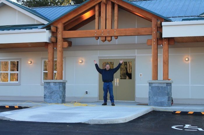

This is our local art services building which uses 5/16" cement board with metal trim on plywood furring at 16" oc.

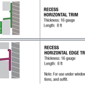

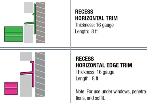

All edges will be supported- see horizontal trim detail below
Yes, lots of sealing of cut edges but I’m willing to pay that price in order to achieve the look I want

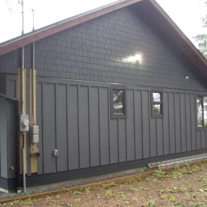

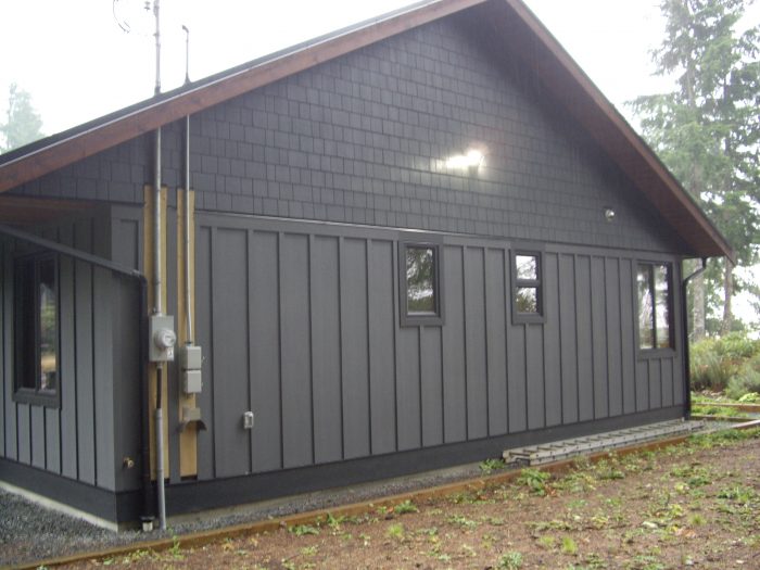

A house I did using Hard-Panels as a base for board & batten:
I like the nice clean lines on that siding Malcolm. Why the inset treated boards for the conduit though, instead of fastening through the siding? Was that a local inspectors requirement?
Bill
Bill,
It's nightmare requirement imposed on us by the power company. You can't bury the conduit in an exterior wall, and the specs call out the length and width of the PT lumber you have to provide as backing. It's bit better once it is painted, but not much.
Given the opportunity to do it again, I'd spring for the extra cost of going underground right from the power pole.

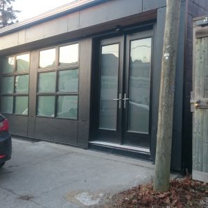

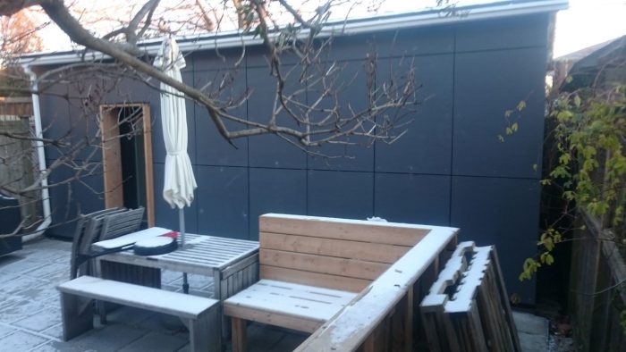

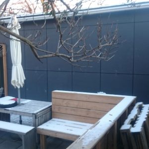

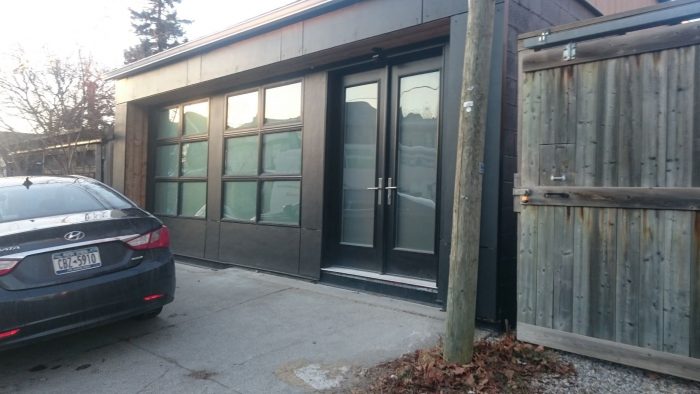

Here is a garage I did with the 5/16" panels. Pretty standard install, strapping over cinder block, no issue with warping. It is still not as smooth as the thicker panels, but not bad for a budget finish. Definitely a lot of cutting an sealing edges.
有额外的捆扎在边缘上,每个edge has its own set back about 1.5", this way you get the nice shadow lines.
Didn't use any flashing at the gaps, couple of years down the road, it is as good as the day installed.

The edges were primed and then painted to match the front. The back of the panels were also primed.
Open cladding design, home to the occasional spider but not much else.
The hard part with these is getting the panels the right size. I found it easiest to stack and cut all the ones that sit above another at the same time. This design is not forgiving, there is nowhere you can cheat if things are off slightly.
Any tips on the tool and techniques used to make the cuts?
Also, what fasteners did you use?
The furring runs only vertically, at the vertical gaps it was just painted black. You can see if you look for it, but not noticeable at any distance. Where you see a screw in the pictures, the furring is running from top to bottom.
The screws were shorty GRKs, they are hard to find. If you are going into wood, you can use longer ones which are readily available. I made two drill guides, one for doing the corner holes and one for a hole along the edges. Needed as you need to keep the fasteners even. In retrospect I should have gone with metal roof fasteners, easy to get in any colour plus they have a gasket built in.
A friend of mine recently did some work with these but went with PL + stainless finish nails for holding the panels. Definitely holds, we'll have to see how it lasts.
For cutting I just use an old circular saw I didn't care for with a 7 1/4" diamond blade and a long level as the guide. If you are doing a lot of cuts, might make sense to make something better. It makes a lot of dust, so get good masks, this is stuff you don't want to breath in.
It takes a fair bit of planning to get everything right, lines at windows and doors have to line up, need an even spacing and minimize the waster/number of cuts. Bigger panels always go faster.
