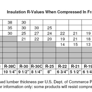

    纤维素可能会稍微压缩玻璃纤维棒,但这种压缩的潜在缺点远远超过了添加的纤维素的优势。当压缩玻璃纤维泡沫时,巴特的R值略有下降,但每英寸的R值增加。我将附加一个图表,该图表显示玻璃纤维棒的压缩与R值之间的关系。[点击图片放大。]

    r19 batt与R13 batt的材料相同,只是绒毛蓬松。将其压缩到3.5“ 6.25”(制造的阁楼)仅是R5的“损失”,但是现在较密集的纤维的空气率改善使其在极端温度下的工作状态更好。
    Focusing on the total post-blown depth of cellulose + fiberglass is the right way to approach it, since the slightly compressed R19s and cellulose will have about the same R/inch.
    笔记that in the compression charts an R19 batt only performs to R18 when installed in a 2x6 wall cavity, and performs at R13 when compressed into a 2x4 cavity. Labeling it R19 is somewhat deceptive since the most common application is in 2x6 framed walls, and is why R20 wall cavity insulation is specified in newer versions of the IRC, not R19.
