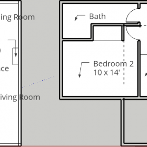

Hi yesimon, thanks for the reply. Attached is a crude drawing of the floor plan (sorry, I'm a total noob at Sketchup). After reading some more articles on this site I'm also leaning towards 2 systems with one head on each floor. The downstairs (15k btuh) head would be in the open space that includes the dining/living/kitchen area. Some of this heat would leak upstairs through the open stairway, which would be a good thing. The only concern would be getting heat to Bedroom 3. Upstairs, the 12k btuh head would be in the large master bedroom, positioned to hopefully blow air across the hall into Bedroom 2 and the bathroom. Minimizing the temperature gradient to bedroom 2 would also be a concern. I'm thinking we could see how it goes and install inexpensive wall heaters (or even radiant panels if it wasn't too difficult) to make up any heating deficit in bedrooms 2 and 3. The doors to these would be open for at least half the day, so that would also help. Since we also want this system to cool, I think we need a head on each floor. I've priced it out and it seems like the market rate for two single-zone systems around here is about $12k. Not cheap, but within our budget.
