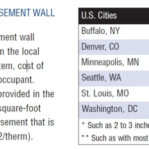

美国研究(见http://www.ornl.gov/sci/roofs+walls/insulation/fact%20sheets/basement%20Insulation%20Technology%20fact.pdf) found that annual energy savings from R-20 basement insulation ranged from $280 in Washington, DC to $390 in Buffalo, NY.
