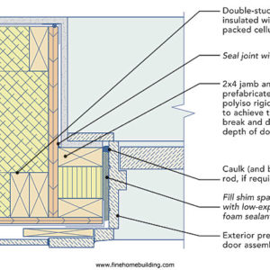

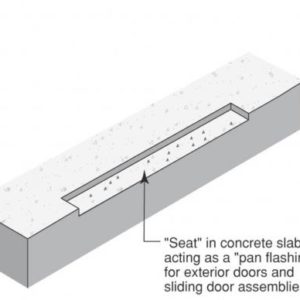

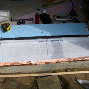

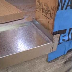

    记住有三件事:
    1.你将如何详细说明粉末闪烁?选择包括:(a)确保您的板坯有口袋以容纳门(见下文) - 可能为此为时已晚;(b)金属板粉闪烁;(c)粉底闪烁,由剥离和粘土制成。
    2. Is the height of the door threshold correct for good integration with your finish flooring? (Adjust as needed. It's usually OK to notch the header somewhat, as long as you don't remove 4 inches with a chainsaw.)
    3. Will the door be able to swing inwards without being impeded by the jambs? (This is a classic problem with "outie" doors installed in thick walls.) For a solution to this problem, see this article:Windows and Doors in Double-Stud Walls.
    有关PAN闪烁的更多想法,请参阅下面的前三个插图。下面的第四图说明了解决厚壁中的内向开口的问题的解决方案不会击中jambs。
