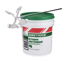

Completely serious. I need a basement for my mud.
由GBA顾问马丁·霍拉迪(Martin Holladay)回答
发布Mon, 03/14/2011 - 20:46
Common Martin....you could have built a mud room instead of a basement.....how much mud does a person need? 8-)'
Tim,
我有一个寄存室,我很高兴我拥有它。这是给mud from my boots, not for sheetrock mud. It's on the north side of my house, and it freezes, so the sheetrock mud goes in my basement.
When it's 20 or 30 degrees below zero, mudrooms freeze, unless you want to dump heat into them. I don't.
只是抽搐你的链条马丁...播放言语...“泥房”
Martin,
you did not exactly answer Tim's question
"How much Mud does a person Need?"
我想说普通人可能不需要存储“太多”的泥浆。
How much do you need to store and what do you use it for?
Have you thought about buying it in powder form and adding water as needed?
I think he hoards mud....
