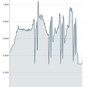

I have electricity monitors on all my splits. Here is what the defrost cycles look like on my energy monitor
I don't have a tool that would accurately measure those temperatures. I think my defrost cycle, when working, looks similar. When it's stuck, it's a continuous 30W or so. I guess I will ask the installer to come out and have a look.
